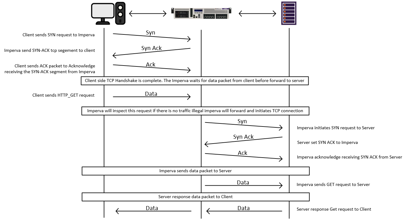

    Hi everyone,
    I've done an analysis of the typical behavior of the TCP 3-way handshake on the Imperva Gateway WAF in inline mode "IMPVHA-Bridge". Based on the packet capture (pcap) traffic in my lab environment, I've reviewed the connection behavior in detail and attached the capture here.
    If there are any mistakes or things I may have missed in my analysis, please feel free to let me know.
